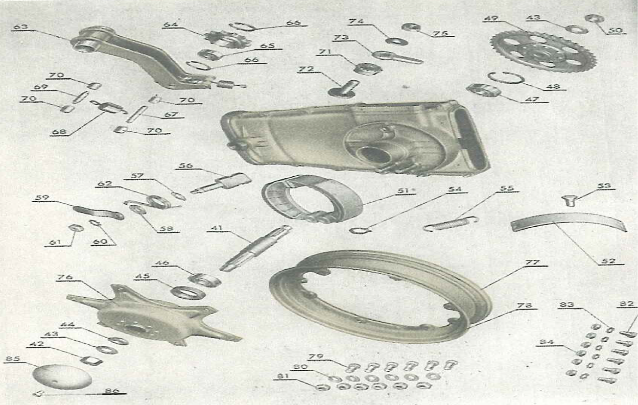

Hello Yianni,
Other than lubricating it you could try heating it up with a butane torch or similar to get it off. Click on the picture to enlarge it.

![](https://secure.gravatar.com/avatar/fa3fb946b7a2e1b72d50fd1f0a3452ea?s=80&d=wavatar&r=g) yianniMember
Hi there.I need some help with a Cezeta that a just bought.I started taking everything apart and I can’t take out the back wheel nut.Any easy way for that?Any tricks?
Thanks,Yianni.
Thank you.I already tried that,but nothing!It’s a stubborn one 🙂 Im going to try again.
![](https://secure.gravatar.com/avatar/cca6b15ef17f1bf546d3abd386f1762e?s=80&d=wavatar&r=g) BlairMember
Hi guys. My memory isn’t what it once was, but that nut/shaft is left hand thread too I think.
![](https://secure.gravatar.com/avatar/74d9813526c60a573e1722024a902c55?s=80&d=wavatar&r=g) oldmgsMember
Yes – it is left hand thread.
