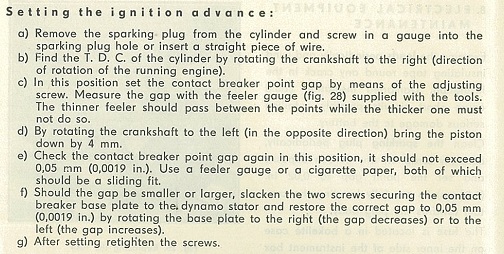

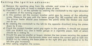

The user manuals for both the 501 and 502 show the same settings for setting the points as below and this is available as a PDF download in the members download section:

Can someone confirm this is correct or has anything to add?

From the stuff i read the points should be just coming apart when the piston is 3.4mm before tdc. I think i’ll be making a mark on the dynostarter when i’ve got the head off to measure it. What a hassle!

Yes to be fair its not really clear on that unless you have one of the factory points tools. I guess once you have the mark on the dynostarter then you will be all good. I must have a look at the marks on my one.
Lets know how you get on in case someone else needs the info.

Yep you guys are right. Directions as per what Mike said.
I just whip the head off, engine in situ. Wind her over by hand until you are 3 to 4 mm (without being precise at 3.4mm) before TDC, and move the points plate round to suit the points just starting to open. (You could use a dial gauge on the piston/engine to get the 3.4mm before TDC precisely of course).
I used an old zig zag roll your own fag paper between the points and moved the points plate til the paper released as the points opened… that helped a bit and got it as accurate as I could.
Then set your points gap at TDC… all done.
